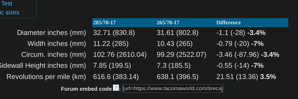

He’s actually going down an inch in diameter, not just reducing width.
@SaskRebel you’ll be fine with that size. Your speedometer will be slightly affected as will your odometer. Basically, at 60 you’ll be traveling 58 mph. Not a huge difference but it’s good to know going in.

What am I missing… OP said he’s going from 285-70-17R to 265-70-17R that’s just the width that’s changing… right? 17 is rim size, 70 is height of sidewall… 265 is width of tire…
The width and sidewall are actually a ratio in tires. Wider tire, same sidewall designation, as in 70, ends up being a taller tire. In tires sizes, 285, 265 is the actual width in Millimetres. The sidewall however is not. For example,if the 70 on the sidewall referred to its height in MM, 70MM would only be 2.5", whereas the sidewall is closer to 185 MM in height.
The sidewall height is a percentage number of the width. 70% of 285mm's is taller/more then 70% of 265 mm's.
Thought you were an engineer that knew everything :rolleyes: :Big Laugh:
I always expressed a 70 sidewall as .7 of the width, a 60 sidewall as .6 etc. but your percentage explanation is probably much easier for most folks to understand. Good explanation.
I just learned that like 2 days ago. I thought the sidewall was a fixed amount, didn't know it was a ratio till recently.
