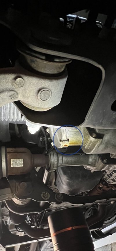

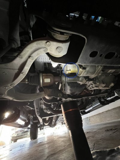

What is this and why is it leaking oil?
SigEp418
Nov 15, 2018
21
32
KY
5.7 Hemi BTS Edition
I’ve come out to a small puddle of oil under my truck the past two days. See the pics below. This area appears to be where it’s coming from. What part is this and why is it leaking. Only 44k miles. It’s circled in blue. Thanks!3491DD76-E299-45AA-9AB2-008F7D4F0406.jpeg64F51DDB-C93E-4FDC-BF05-1D9DB53D05B1.jpeg

No, not since 05/2022. Could it be coming from the filter?
Could be. Need to take a closer look to see if you can tell where it is coming from.
That is the bottom of the electric power steering rack. As @ThunderMug95 and @HuskerRam said, your oil filter is directly above the rack, and oil will get on it during oil/filter changes, so it could be old stuff. A little brakleen on a rag will clean it up nicely.
If the oil is just on the bottom there, see if it is fresh. I would be concerned that the gearbox of the rack might be leaking, but that would be a rare thing, IMO. Plus, the gearbox would have a heavy oil or most likely grease in it.
The biggest thing would be to see if it's running down from somewhere else (most likely).
Keep us posted.

I’m gonna try to tighten the filter when I get home today. I found a post on a different forum where the filter had rattled loose and was dripping oil from the same place as mine. I am going on 9 months without an oil change. I have a company car, so luckily this isn’t my dd.

Yep it was a loose filter. There was an obvious drip coming off the bottom of the filter and I was able to get about 1/3 of a turn with my hand.
I’m not mad at my shop, it has been 9 months since the oil was changed. I’m sure it just slightly vibrated a little loose over time.
I’m thankful for forums like this and the knowledgeable people on here. Thanks for all the help!
