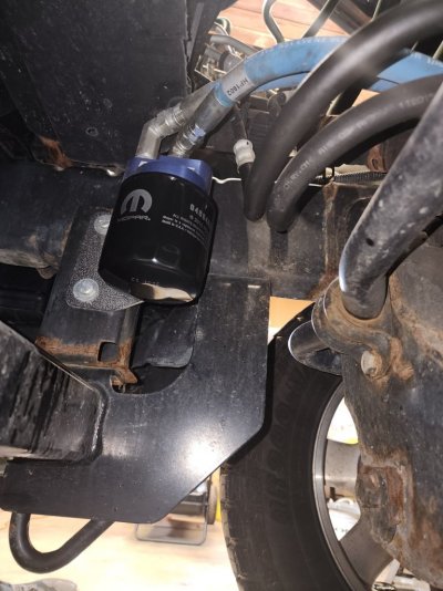

Yep it was a loose filter. There was an obvious drip coming off the bottom of the filter and I was able to get about 1/3 of a turn with my hand.
I’m not mad at my shop, it has been 9 months since the oil was changed. I’m sure it just slightly vibrated a little loose over time.
I’m thankful for forums like this and the knowledgeable people on here. Thanks for all the help!
People make mistakes. Oily hands won't have the same grip as clean hands. I wouldn't slightly believe it vibrated loose. But I also wouldn't condemn someone for making a mistake.
On another note, to save from oil running all over the steering rack I (among other members) put an oil filter relocation kit on my truck which moves the filter to the frame rail. No leaks, easier to access, can visually see any leaking from the engine bay with the hood open.
I think you can switch out the nipple on your kit,to the older 3/4-16 nipple,and that opens up more options for bigger filters like the Royal Purple 30-8A style filters.
Yea it's possible. I haven't worried about doing it yet since I run the 899 Mopar filters which are larger than the 339 our trucks call for.
