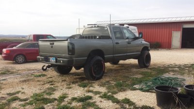

I have a 7" maxtrac lift on my 2007 2wd. 17x10 wheels and 35x12.50 general grabbers. I can clear 37s with this set up but I like my 35s.

Sweet looking truck, was kind of hoping that a 3" body lift would be able to clear it as that would free up alot of money for other mods. But that just means I will do other little things like anzo head/tail lights, light bar, things like that while saving money for the lift/wheels/gears.
Thanks for the pix it definitely gives a good visual reference for lift versus tire size.
