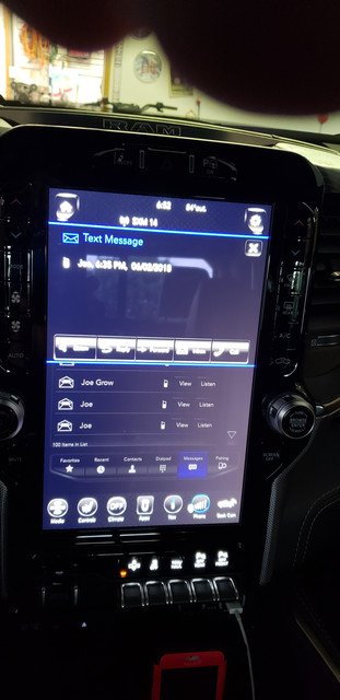

I took some pictures of what is happening with my S9+
Here is a message I received, this works ok but I have to go to the phone screen to listen to it, the old truck just played the message from the pop up
Once u listen you can hit reply and it takes you here.

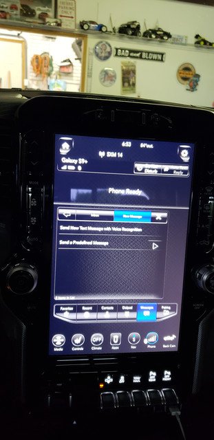

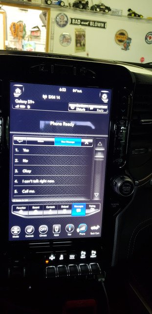

The top button makes the truck ask you for a standard, already drafted reply, the bottom one takes you to a list of drafted replies
Do you have the Android Auto app installed on your S9+?
And have your S9+ plugged into a USB port on your truck?
This is what is necessary to send custom voice text messages on my 2018 Ram with 8.4 UConnect. Not sure if it is the same on the 2019 with the monster 12" screen, but it could be.
