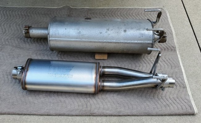

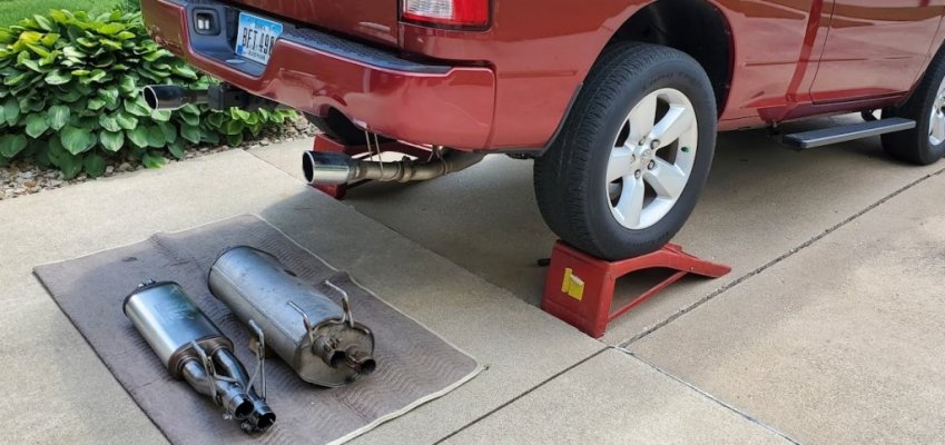

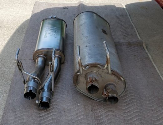

I have the exact same headers and setup on my 2014 5.7 hemi 6-speed. Installed the MagnaFlow 6 months ago. Amazon link is https://www.amazon.com/gp/product/B07M79ZD68/ref=ppx_yo_dt_b_search_asin_title?ie=UTF8&psc=1. Looks like the price has gone up, but it was very easy to install. Has gotten a little louder over time. Deep and mellow tone.
Regarding drone, I never noticed any at all until recently. There may be a little at 1500 rpm but since I ALWAYS drive in Tow/Haul (Sport) mode it never shifts into 6th gear and my rpms are just above the drone range.

Sometimes pictures help. Here is the MagnaFlow compared to the stock muffler. Works well with the long tube ARH.
Direct fit, very nice.
