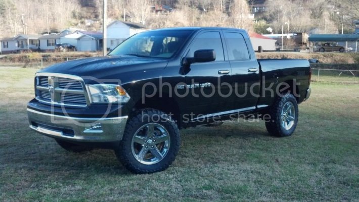

What Size Lift And Tires Does This Have?
kcbigbadram
Jul 19, 2012
502
227
kansas city
HEMI
I remember seeing that truck somewhere and reading that its a 4" kit. But I can't remember where I saw it.
mattman_13
Oct 21, 2012
1,095
221
4" on 35's
Too big for a level to small for 6". Its address has superlift in it. If it were body you could see the E brake line drooping along the frame.

I say do a level and a 3" body lift on 35's
Do some all terrain 35's like the truck you have posted has on it and it may even help your truck performance wise if they are considerably lighter and lowering your rpms at higher speed. Here is a pic of my truck 2.5 level front, 1.75 spacer rear, 3" body.

-Yea, I had factory 20s with that set up. You only need 1/4" spacers to make them work. Its not the suspension lift that makes them unusable. Its the width of the tires being put on the rims. Use 1/4" spacer and you can fit a 35x12.50
-The truck you posted is a 4" on what looks to be a well worn down 35" tire
-4" suspension lift plus install and alignment will put you in the 2,000+ range easily
-2.5" level kit (130 or bils 220) self installed, plus a 3" body lift (400) with a $600.00 install, and a $70 alignment would put you at 1200.00 the cost of just the 4" lift before install.

I agree with everyone. It does appear to be a 4" lift on 35's
