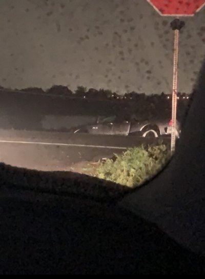

I’m gonna look around more. The clicking didn’t start until i had the accident you probably do or don’t know about, i think i mentioned it earlier. Essentially, jumped a curb, truck fell directly on the passenger side tire and put around 5-6 tons of force on it. It was at such an angle the tow truck driver said i was lucky to still be alive, and that the only thing that saved me was that the frame dug into the ground. He also told me he was 90% sure he was gonna lose his truck because of the angle and the weather conditions. 298971c9dcfab904a99701fc63414b7f.jpg

holy **** bro.
I missed that for sure, glad you are good.
