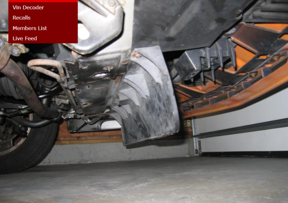

My mother's 92 RS Camaro did this waaay back when. It was just missing a simple plastic air dam under the car. With these trucks and all the criss-cross electronics, I'd consider changing the batteries in your home remotes. ‍
I had 92 Camaro that had the same problem, and the same solution.
Those stupid things had literally no grill whatsoever for airflow, and the radiator was right behind the non-grill.
There was an air dam that hung down below the radiator and all the air was scooped up from beneath the car.
I still remember the sound that air dam makes when it scrapes it's way over, and onto the other side of a parking curb. Both directions.
You think that was bad, I had a ZR-1 Corvette. That was a real bottom feeder. If it was't moving, the oil and coolant temps would skyrocket, literally. Watching those temps creep into a very uncomfortable zone. Once you started moving, the temps would come down fairly quickly, but watching those needles rise made you buttocks pucker.

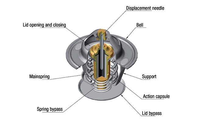

Thermostat is usually the first place to start. The *Pin* ....or sliding shaft where the valve slides up/down on can become scored after many years and heat/cool cycles. Not always...but 'sometimes' they can. I've seen it. I've even seem them get bent!
In some cases it can cause the sliding valve to 'bind' and not fully open. Sometimes they can open ok in a pan of boiling water, but act differently under water flow conditions. If there is pressure sideways, it might bind. Sometimes if ya slide the valve back you can see scoring on the Pin/shaft.
There are a few things which can fail on a thermostat. If it cannot open enough, that would restrict coolant flow which could cause the truck to overheat at highway speeds. If you bother to take it out, I would replace it with a new Mopar T-stat anyway (notice I didn't say cheap parts store t-stat). Even if they 'look' good, I've still had it (after wasting time looking at other parts of the cooling system) where the thermostat was the ultimate issue.
