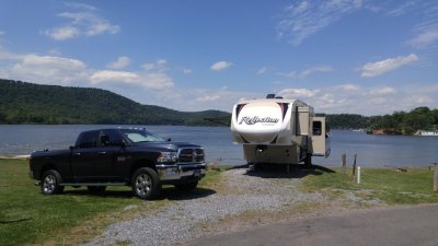

Towed this last weekend.
It's the most I have towed so far. Had about 8,500 lbs with the trailer and my gear.
6.4 Hemi 3.73 seemed to handle and drive better then last them I towed with about 6500 lbs. I know that sounds wrong, but it was how it felt to me. Perhaps it was me being more comfortable this time, even though I was pulling 6' longer than last time.

Looks like a nice little camp spot and a very nice camper

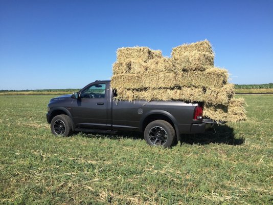

48 bales, about 2,400lb. Had another 137 bales on the hay rack (not shown), so I was pulling another 6,800lb or so (plus the weight of the rack). My sons are married and out of the house, so I drop-bale and pick 'em up by hand. This is all oat hay (nurse crop for a new stand of alfalfa), which will go into my cows this winter.

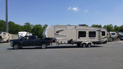

Just made a crazy move to a 5th wheel. Under 2K pin weight & 10.5K loaded. Haven't towed it too far yet, but the rear is still higher than front so I'm happy.

Finally got it out for a 2+ hr trip to the lake. Pulled perfect on the flatter portions and okay on the grades. This was at about 10.5K# loaded (wife packed for a month rather than a week). Saw same MPG i got towing our previous 7K loaded pull behind to same location.
One thing I'll say is the torque mgmt really sucks in these trucks and the tow/haul mode shift logic is off. Mine skips 3rd regularly and goes straight to 2nd from 4th causing it to scream up the grades when its not necessary. It'll do fine for a while, but I'm thinking a 3500 CTD is in my future when I hit the lottery :).
