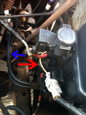

Went out for closer inspection today and took a better picture. The blue arrow is pointing to the leak, which is currently electrical taped (bad idea?), while the red arrow is pointing to the thing that the line comes from (evap canister?). Is this an urgent fix and how much will it cost? Sorry about all these questions but I've never had to deal with this type of thing before.
Also let me add that the truck drives very well, I've been paying close attention and haven't heard any funny noises or had and vibrations, or any other problem.

It is called the evap canister purge solenoid. It pumps fuel vapors from the evap canister to the throttle body. The canister is down by the fuel tank and collects vapor for instance when the tank heats up it keeps it from expanding by relieving pressure. It's an emissions thing so fuel vapors don't dump right into the atmosphere
Pm user ramtech he can give you an idea. He is a chrysler tech and can probably find you a ballpark estimate

Were you able to look over the power steering lines to make sure they weren't leaking? The only place on them that would leak is where the hoses connect to the steering rack (1500) or box (2500 3500) or where they connect to the cooler and pump. If you don't see anything out of order then you may breathe a little easier.

Yes I slid under the truck and checked the connections, the tubes were all dry and tight. Definitely not anything coming from the p/s lines. I even turned on the truck and turned the wheel to both full cuts and got back under both times and couldn't find anything. I think I'm in the clear, and that dealership just wanted money (what's new right)

Good to hear. What may be happening is some fuel got in the evap canister somehow. Those lines are only supposed to have fuel vapor so they can leak if liquid fuel gets in there. Perhaps it just condensed there?
I found that line on dodgeparts.mopar.com for around $20
it was called Vapor Purge harness
