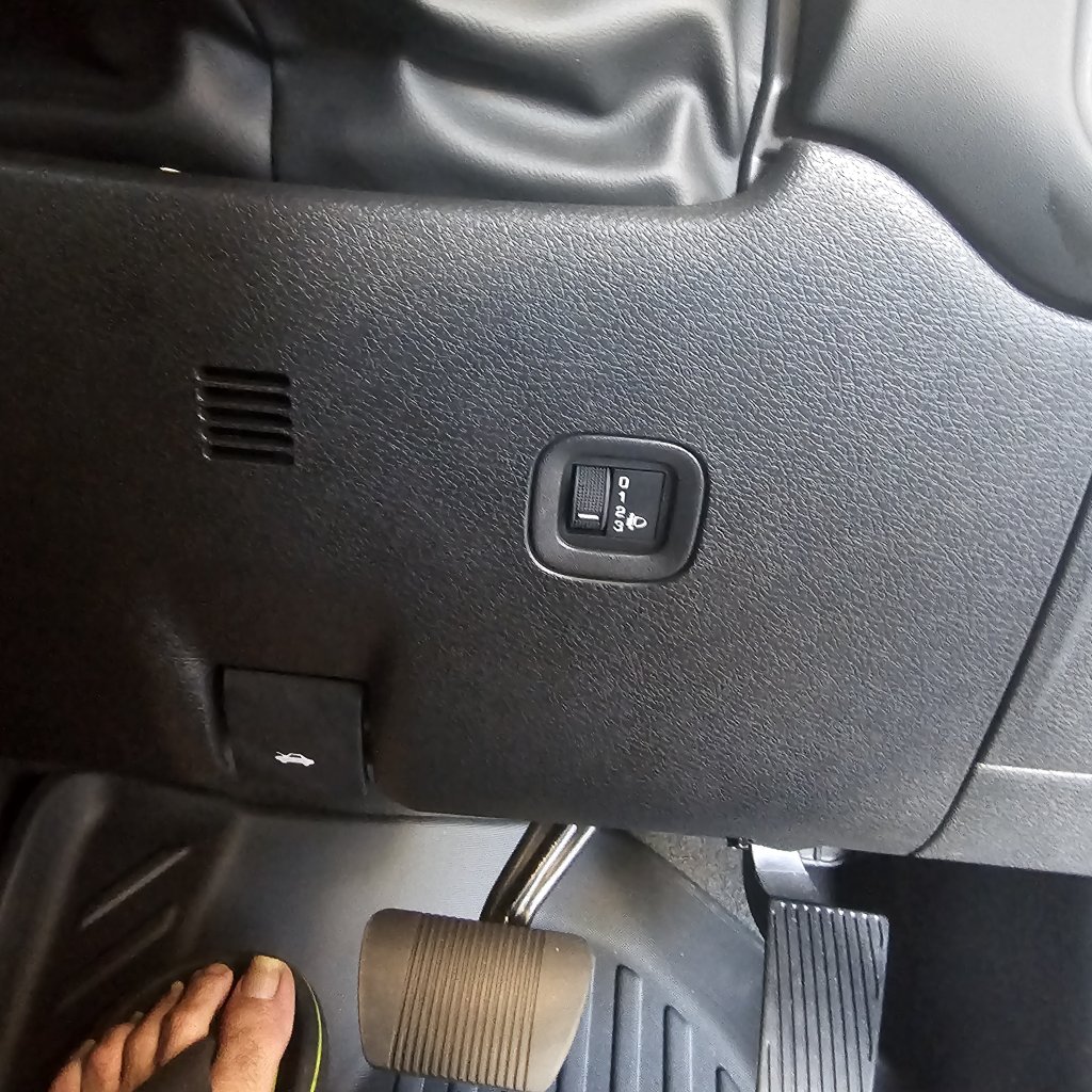

Looked in user manual and cant find it anywhere. Its under the steering wheel. Thought it may be a headlightlight adjuster. Im stumped.

Help me out here, what does that thing do? I don't have it on my truck. Guessing you have a higher trim level truck.
I tried the googs and I see why you had to post it here. Not easy to find information about it.

Looks like the headlight angle adjustment.

Never saw that here in the US. OP is from Australia so that makes sense.

The idea is if you toss enough weight in the back, it will make the truck squat, shooting the headlights up and blinding oncoming traffic

It is an Australian requirement that the dial provide vertical headlamp adjustment. There are a few discussions about it on Facebook.

gees...i was going to guess pedal adjustment, (another useless feature), however, i never heard of a headlight adjuster. do they have little motors on them that move them up or down? How exactly do they work? Or, was that a joke?

Headlight beam height adjustment switch. If yours is connected/working: drive up to a wall/garage door etc. Best at night. Turn on Lights. Move that switch. If connected it should adjust beam of lights down a lil bit. Used when vehicle loaded down changing front end height. URL below to see, but do not go into the weeds on it, just to show U, I could not find exact RAM part listing, just not gonna spend that much time on it.
Just FYI, on my 2006 Honda Gold Wing I have the same type of control to adjust where headlight beams aim depending upon load on Bike:
ie., riding 1 UP or 2 UP. Especially riding 2 up with a lot of loaded stuff on trunk/bags etc.,.

Yeh its an Ozzie rig. So rang the dealer and wasnt until i got to the 3rd fella on the phone that i was told its to adjust the headlights. Its a Laramie so do you guys have this feature on your trucks?

Tried the garage wall and didnt see any change. Spoke to another dealer today who had better knowledge. They said the adjustment is very small and will be mostly noticable on the open road so going to try it out when im able. I'll report back.

Before I retired, I worked on a team implementing auto-leveling headlamps. This was on the Ford Licolns and was meeting a requirement for the Chinese market. The headlamp leveling was determined by the vehicle's position. Adding weight to the trunk or the back seat would cause the headlamps to respond and relevel. It was done by motors running a worm screw.
I was kind of hopeful and, from listening to the chatter among the Ford employees, looking forward to seeing auto-leveling headlamps installed in all vehicles (this was back in 2016). Doesn't look like that happened. Something needs to be done because people modifying their headlights is out of control, at least in my area. It is getting to the point where sunglasses are becoming a requirement for nighttime driving.
