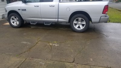

Mbrigh3
IG: Stormtrooper_5.7
Aug 27, 2016
1,142
644
MD
SO I am rocking the 3/8 inch 10mm spacer on my ram which bolted on but I would like longer studs. Anyone have a link to 2" studs that they would recommend ?
