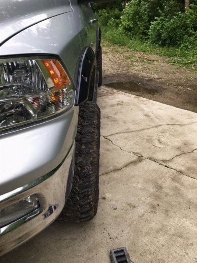

I have 1" bora spacers along with the wheels at a -24mm offset20180913_130932.jpg
