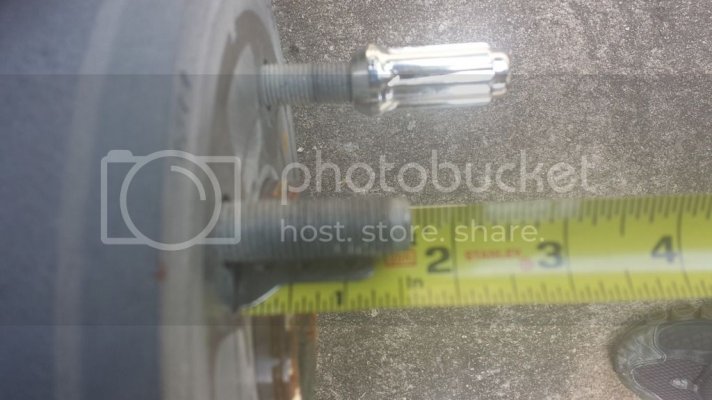

Atlanta GA
I had my rear wheels off this past weekend and on my 2015 so I remebered this thread and took a picture (boy I'm spoiled by camera phones). the stock studs measured just under 1-11/16". Not sure if that helps you out any but hopefully so.
