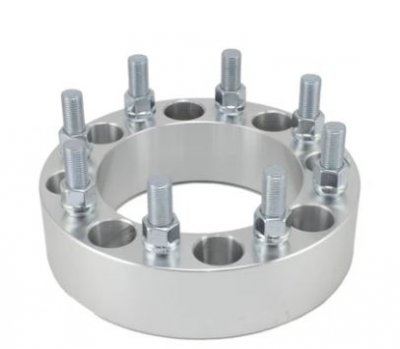

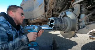

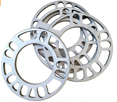

ahh brings me back to the Jeep days
spacers - reduce threads engaged (by how ever much thickness)
Adapters
haha
