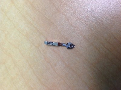

So I’m looking to get some of these female crimps so that i can install my harness that goes into the back of the 8.4a pigtail. I can’t find them anywhere. Any help would be greatly appreciated. Thanks.
I’m attaching the photos. for some reason i can’t upload them directly in the post.

I tried autozone they carry nothing like it. And I can't find anything on amazon. I'm going to the dealership tomorrow hopefully they will have some..

Those look like the female contacts from a MOLEX connector. Radio Shack may have them and believe it or not an appliance repair service may also have them (washers & dryers are full of Molex connectors). it would be a good idea to take the connector housing (shell) with you to make certain you get the correct ones that lock firmly in place in the connector shell and are of the correct length. If all else fails do an ebay search using Molex as the keyword.
