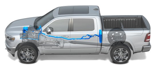

The eTorque is a mild hybrid system that provides more torque when needed and better fuel economy. The traditional alternator is replaced by a generator system. The battery is not serviceable and uses the generator and regenerative braking to charge. I recommend the eTorque, personally.

Yes, battery is behind the rear seats
It's just the eTorque battery that behind the seat, the regular +12V battery is under the hood and is used for the initial starting of the engine and powering the accessories

Battery not serviceable??? Sure it is, it sits behind the rear seat.
Hard to justify the benefit of etorque vs. costs if planning on keeping the vehicle for many years. If plan is 3-8 years, I could go with either option. Over 8 yrs., I personally would opt for the non-etorque option. Supposedly, they are warrantied for 8yr/80k miles.
Not serviceable as in the consumer does not have to do anything to maintain the battery. It is a sealed lithium ion battery.
