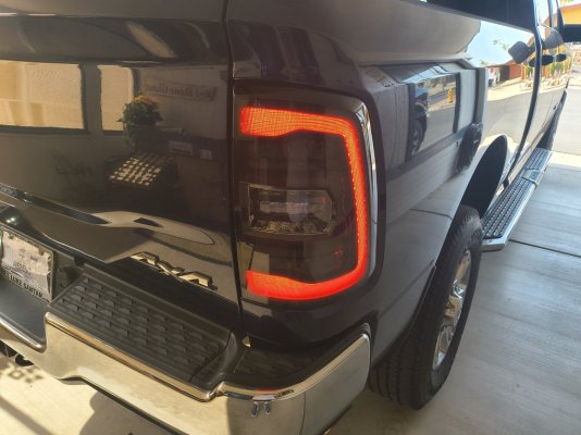

I just installed some Morimoto XB Hybrid LED tail lights on my 2024 2055. The model I purchased is compatible with the OEM incandescent bulb arrangement. No hyperflash, no tail light out messages on EVIC and they look awesome.
They aren't cheap and there are other brands out there to consider.
Morimoto LED Tail Lights
