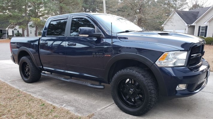

If you only do a 1.5" front lift, you'll have little over 1" rake, but surprisingly the truck will look level. Mine is set up with 1.5" front lift, 3/4" rear spacer and AirLift 1000 airbags (running 8-10psi when unloaded). If I were to do it again, I'd go straight to 2" front end lift and 1" rear (spring or spacer). Personally, I like running air bags in the rear, used them in other vehicles for decades. You can play with air pressure when unloaded to maintain the stock smooth ride and pump them up if carrying a heavy load. I towed a 6,000# trailer couple months ago , air bags set at 22 PSI, towed very nice.

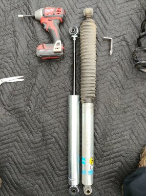

I have not used the Eibach struts but I have used both the Bilstein 5100 struts/shocks and ProComp struts/shocks, and stock springs and Superlift 140's and Eibach springs.. had the suspension apart and together a lot of times trying to get it all just right.
The ProComps are considerably less firm than the Bilsteins, much softer feeling on everyday bumps but less responsive if you want or need to change direction quickly. I don't know where the Eibachs fit in there. The ProComps are inexpensive, but also just purely on visual appearances they do look a bit cheaper - little stuff like the welds, the finish. All good enough I'm sure - not to imply they're low quality but you hold them side by side with the Bilstein shocks and you can tell which one is the lower priced set despite that both are on the affordable side.
Seems like everyone has an opinion about the Superlift 140's, in my case they came with the Mopar lift kit I put on my Ram when it was new. Since my truck is a reg cab short bed I got a lot more lift out of them than 140" wheelbase trucks would. That lift is a bit of why I decided to switch them out, I don't like how the front of the truck rides with the whole 2.8" front lift (stock springs/Bilsteins) and any less there's a whole lot of rake.. more than stock. When I switched them out for the Eibach rear springs it solved the excessive lift problem, rides very well. Like the Superlifts the Eibach rear springs are progressive so they don't feel rough despite a claimed increase in spring rate.
End of the day I wound up running Bilstein shocks and Eibach springs on four corners. I don't know if it's the best it can be but it's the best combination of tight handling and forgiving compliance I've enjoyed so far. Well, ride is subjective everyone likes something different.

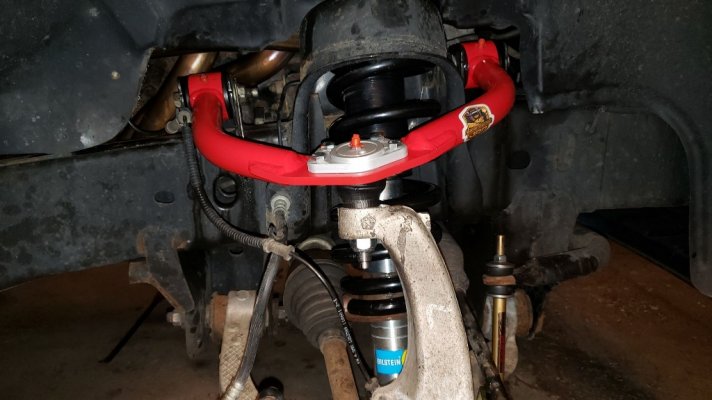

Check out jbaoffroad.com
JBA makes a great upper control arm. Spend a few minutes on the website reading about them and watching a couple videos about the UCA. I think they’re one of the best out there, especially for the price.
Like novelmike says...they're great UCAs. I've had mine on for over a year.
