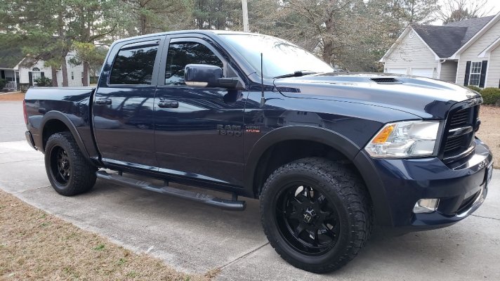

This are brand new fresh installed SLF-140's, 41.5" with the 300lbs i had in the bed,
check post#427 and #430, notice the date in post#430, June 18,2019
https://www.ramforum.com/threads/2014-ram-1500-express-crew-cab.124750/page-43
Now check post 453, Jun 30, 2019
https://www.ramforum.com/threads/2014-ram-1500-express-crew-cab.124750/page-46
Hodge replicated with the same impressions he has measuring pretty much the same sag in this Eco diesel truck in post #455
post#462, they went down a little more by July 2, lol like damn marsmellows with just 300 freaking lbs of weight. POS springs. https://www.ramforum.com/threads/2014-ram-1500-express-crew-cab.124750/page-46
On top of that they can brake under stress, thanks but no thanks Superlift, the 140's are not good coil springs
