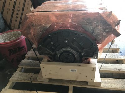

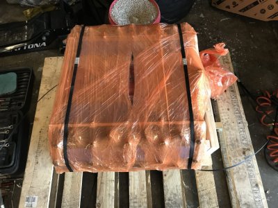

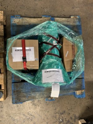

Waiting on Thitek for the heads. Final assembly and then tuning.
Transmission showed up super fast.
I'm probably going to upgrade to the 3.0 Whipple when it's released for the Ram. If anyone wants a gen 4 2.9 head unit keep an eye on the for sale section in 2-3 months.71801609_2406042559716417_8120220707763257344_o.jpg

That truck is going to move out! Awesome set up!!!!

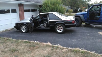

Can't wait to see it done exactly the build I wanted. But the fact I got a fat pig I got a new toy.View attachment 224929
Sent from my KYOCERA-E6920 using Tapatalk
Sorry to hijack @ScLeCo but @Ohio5pt7 WTF man, you holding out on me!?!? Need some info on the Fox body lol. Sorry, I am a Mustang guy and my 1st one was a 92 LX hatch. Love the Fox platform for it being fairly light weight and super easy to work on. Thoroughly enjoying my 13 tho.

88 351 cleavland [emoji2962] not W. Trickflow aluminum heads comp thumpr cam .535/.540 tiny street cam which is going bye bye 3500 stall also going bye bye currently 10.75:1 compression strange rear end, performance automatic super comp c4 with trans brake and reverse manual pattern 4.56 gears full spooled. The list goes on was a street car now going strictly track. Runs 10.60s shifting at 6k. hoping with new cam, intake, domed piston(13.1)stall I can get it to low 10s high 9s then spray to 8s.

Nice build! Must be a lot of fun. My Fox was a typical bolt ons 5.0, fun street car. My 13 is strictly a street car but building it for the twisties. Has bolt ons and tune then doing lots of suspension this winter. Still deciding on brake package for the spring.

My next Stang will be a gt350r. I though about building a road car but no where to use it around here so drag it was lol.

God you're such a tease. But I understand not wanting to take the wrap off
Sent from my SM-G950U using Tapatalk
Sorry, trust me I want to!
It's going to be sitting for two to three weeks.
I'll take more once it's on the engine stand and the valve covers are on.

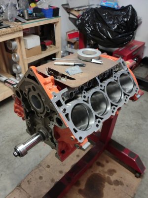

Yeah i understand. ive been through the same process. just promise me pictures of your fingers deep inside a cam bearing lathered in assembly lube once you're ready to get started.
preferably...... 2 fingers minimum :D hahahahah
