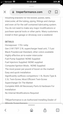

This is from Whipple’s site. It’s close to 500. Realistically, 470 whp on a “400” bhp motor.

170 hp gain on a 310 rwhp motor. My only point is you almost lose 100 hp through the drive train.

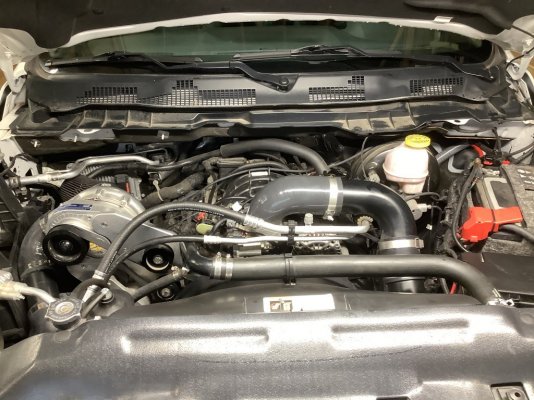

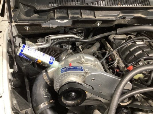

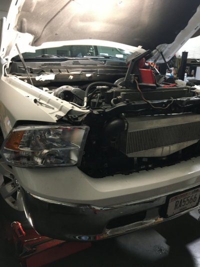

I almost did the edelbrock setup but was talked out of it for Procharger on my vette since then I went with it for my ram,no issues until you’ve in the 14+ range then a dedicated belt is needed.But good luck don’t know if all the tales of heat soak are true IATs are the enemy.0719F5D3-05CD-42C5-9A28-2AF48263DAE8.jpegB52FA39A-8DDD-4690-8538-30DB8342B9BB.jpeg40584268-730C-4B6D-85EC-F9DCB6940493.jpegD90DE339-1C27-4DB6-A1F9-4AEC1195819A.jpeg
