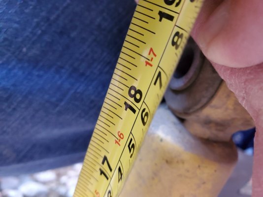

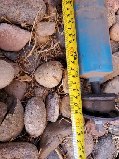

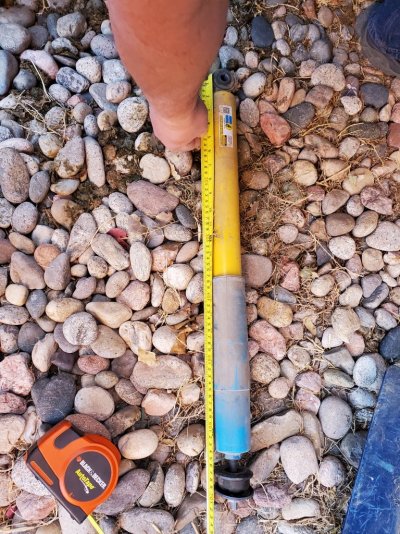

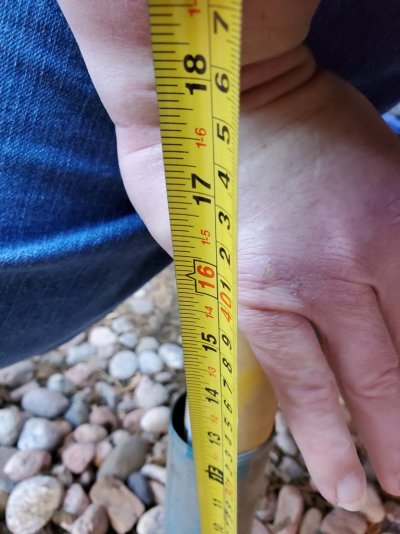

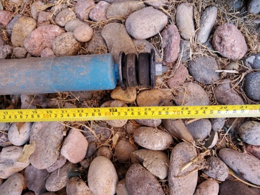

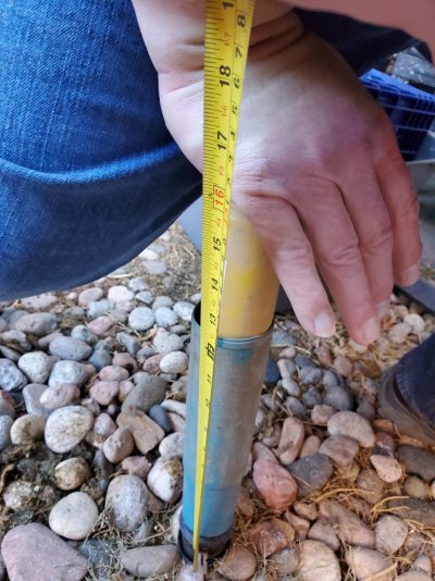

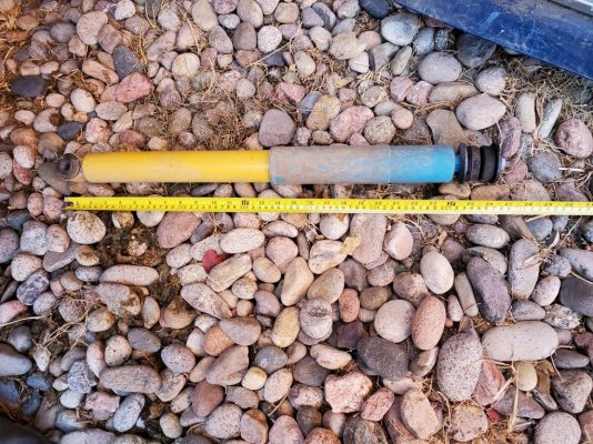

I have some good pictures and some terrible pictures of extended length OEM Bilsteins and my wife's attempt at taking pictures of the compressed length OEM's.

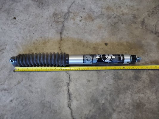

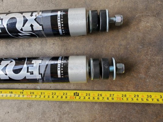

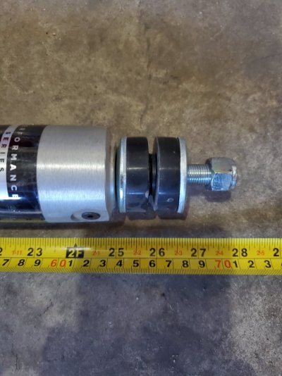

I originally put the Thuren tuned Fox shocks with resi's and the .5" lift on the front and the Thuren tuned Fox OEM length on the rear with the stock springs. The front felt better, but I still wasn't happy with the rear. I ended up getting the Thuren Fox extended length rear shocks and the Carli +2" rear springs. MUCH better handling and ride!
I also switched out the rear trackbar with a Thuren one. That helped the up-and-left over bumps become a straight up and down action.

Where do manufacturers measure from. Very end to end or?
