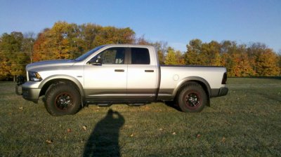

Here's how mine sat with maxed bilsteins and 35s

Got them installed this morning @ 2.8". I freaking love it!!!!! Looks amazing and ride still feels great. Front fenders went from 36"-36.25" to 39". It's amazing what a difference a leveling kit makes. Next weekend hopefully the Zone 1.5 body lift, Top Gunz 1" rear spacer and rear Bilstein's will go on. Then I have all winter to pick out wheels and tires. Thanks for the help fella's.
