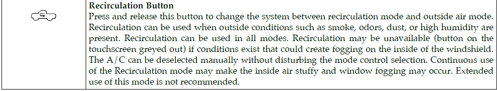

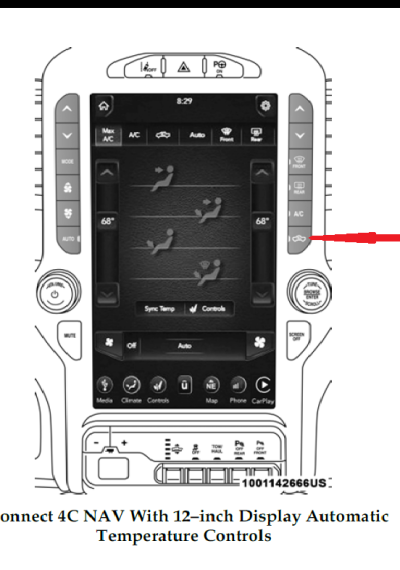

Mine is a 2019 with the 12 inch screen. Yes, I have auto, but what is "center control," and where do I find that?
When you say "dial to the left," I only know there are the up and down arrows for the temp. Do you mean the volume and station control "dials?"
