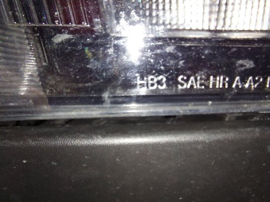

Read the bulb type off of your headlight enclosures and search for that part number.
My Warlock Projectors indicate HB3 which translates to 9005. I used Fahren bulbs, they were straight plug n play with no additional changes and no grief.
The high beams are very much brighter than the halogen. The low beam are much better but not as noticeable as the high beams.
