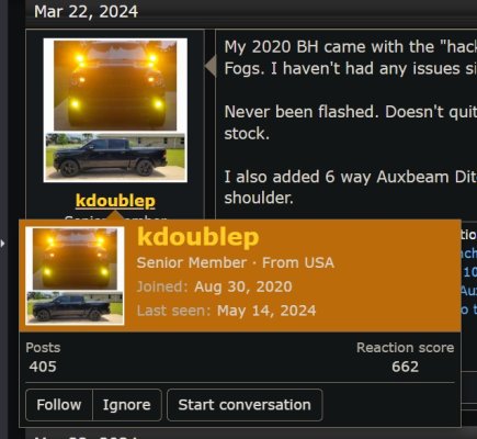

The member you quoted has not been seen in almost 2 years.

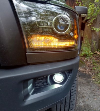

AFAIK, the white LED driving lights in my Warlock, which they're calling fog lights, are a sealed unit.
I like them for lighting up the ditches where I live in the country, but they're useless for fog.
I want to add 4x4 fog lamps on the bumper because the fog out here is as thick as pea soup sometimes.
