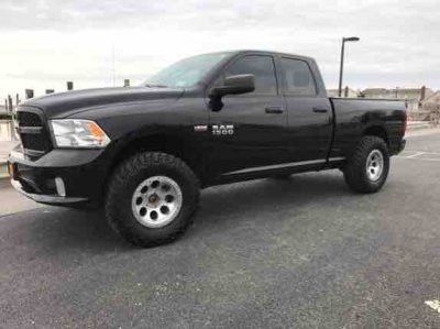

Hey guys new to this forum and hoping someone will b able to tell me if 35s will fit on my leveled 2014 1500. I was hoping to keep same 17 inch wheels and found a set of 35 1250 mud tire's but don't want to waste time and money if they won't fit. Anyone else tried this and how did it work out?

How much did you level? And the bigger concern would be the width of the tire due to the rim. May need a wheel spacer.

Leveled with Bills 2.8", stock rear height .. only slight rub on the plastic when pulling in/out of steep driveways/parking lots at full lock, you learn to just not go full lock and go slower
2014 Express quad, 35x12.5x17 with -12 offset no spacers

He is right, you have max 11.75 inches of width clearence without needing spacers or offset rims. You may want to google the true width of the tire you want to buy.
