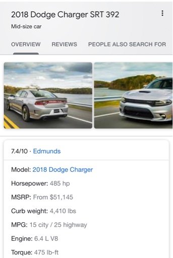

They could just bump up the juice a little in the big 392 and call it a day. No need I see for a bigger motor.
Last year’s model Charger SRT 392 is sportin’ 485hp and 475 pound feet of torque. Unless there’s just something I’m not seeing, there’s no reason for the HD trucks to not already have those numbers.

The charger 392 is a completely different motor. Just like the 8.0l V10 in the truck was completely different in the Viper.
The Charger motor is not made for severe service...
But I am sure the 392 Heavy Duty has plenty of bump room...and I am sure somewhere at FCA there is King Kong to battle Fords Godzilla

How is it a completely different motor?? Is there really that much more/complex performance parts on the Charger/Challenger 392 like there definitely was when you start talking about the 8.0L between the truck and the Viper? Which, from what I was told years ago, the only difference between the Ram V-10 and the Viper V-10 was that the Ram 8.0L, was a cast iron block- the Viper V-10, an aluminum block with all sorts of different power goodies.
But all in all, maybe there is more to the Challenger/Charger/Durango and I guess Cherokee 392 that meets the eye but still, maybe not those types of numbers but certainly more than just the mere 15hp/19tq over the 5.7.

You can google the differences...but to summerize...passenger car application vs Heavy Duty truck severe service application.
The same difference between the 5.7 hemi in a charger and the 5.7l Hemi in a 1500, only on a larger scale.
Look at the difference between the specs for the 6.4l BGE in a 2500 and then in a 4500 chassis cab.
There is a good bit of difference there as well.
But, mainly, different heads, block,pistons, tunes, you get the idea.
The 6.4l BGE in the Heavy duty has more in common with the HellCat engine than the Apache

That’s all fine and dandy but I think we can both agree that they could do a lot better than just current numbers in the 392.
And I said there is bump room in my above post...but at the cost of severe service. The 6.4l BGE goes through the same 300,000 mile test as the Cummins.
The reason there was no power bump for the 2019 RAM HeavyDuty was because at launch they still held the standing as most powerful gas HD and most available payload on a Gas HD.
Now that that is not the case, you will be sure RAM will change that.
In case you didn't know, in 2018 you could get the base 5.7l Hemi and the optional 6.4l upgrade.
Now the 6.4l is the base and only engine option for 2019.
So, 2021, very good chance there will be an optional Gas engine.
Also, a 7.0l Hemi was in the works. It originally was rumored to be a 426 Hemi for the TR version of the TRX. It was shelved at the moment, but that was before the 7.3l Ford debuted.
If you read what RAM says in its acceptance of 2020 truck of the year...they are done chasing the ever climbing towing numbers...but they are very interested in making their trucks do the current work better.
Good times to be a RAM fan...they know how to build a truck.
@392DevilDog hit it on the head, the 6.4 in the trucks is designed for severe duty, the life expectancy of the Charger version would be greatly diminished if you tried to tow a heavy trailer with it all day. There is a alot more consideration of thermal management for the trucks.
