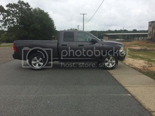

Pic is worth a thousand words right? Here is my set up 20x9 Fuel Vapors with 1mm offset and 35x11.5 Nitto G2s(awesome tires btw). Only difference is I am set at 2.8. I have zero clearance issues and no rubbing anywhere

That picture helps tremendously!
Even set at 2.1 I do not see anything that looks to be an issue with clearance going off of this picture.
And that is the perfect amount of tire showing.

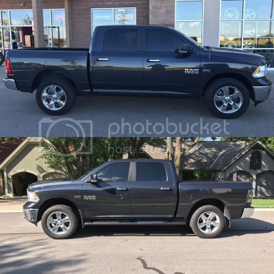

My truck before and after the level. 35 I am thinking will be ok I think. Just nervous. Lot of money.

Looks good, looks to be enough room in there for 35s.

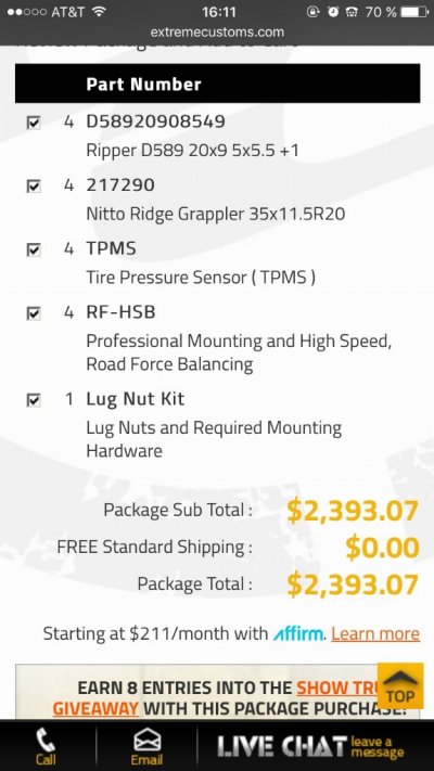

Would prob be cheaper if you can return the rims you bought and get a wheel and tire combo. Check out extreme customs . I used them for my setup and saved a ton on my rims and tires with new Mopar TPMS installed and already mounted and balanced. I just had to put them on my truck and drive The customer service was great Not sure if this is the finish on the rims you ordered but that's a great deal on the combo. Just an example
