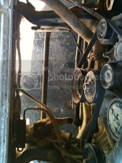

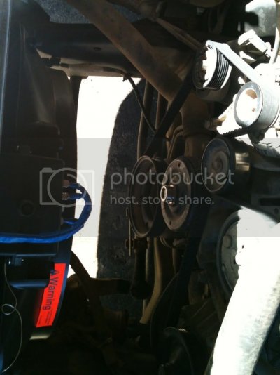

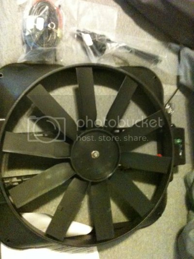

Fan:
About 150.00 from summit very nice unit cools very nicely

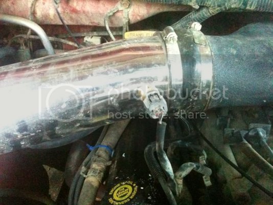

IAC moved to the intake tube

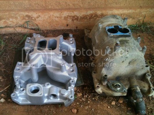

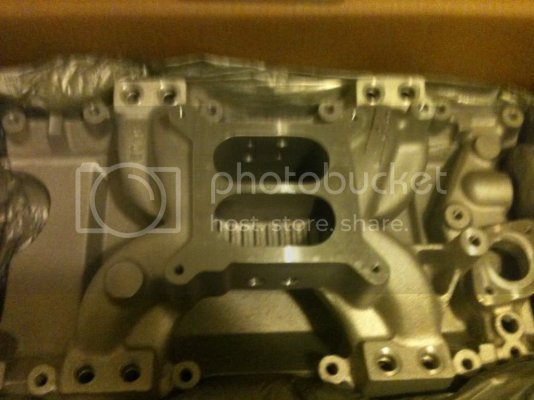

Hughes Intake
Overall looks to be a really good product

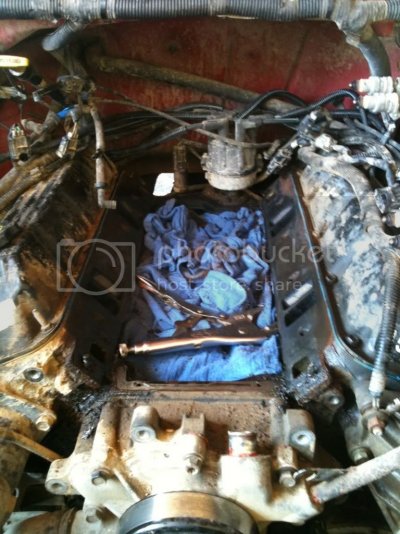

Yep bored 40 over Im going to look into a new block for this though. Todays progress has been slow the tear down went great all except the front two intake bolts seems that they where broke off and just sitting there. Well the are stuck pretty nice so Im going to have to drill and tap just waiting on my buddy to bring my tap set back.

Looks like a mess...but with a bit of patience and work you should see some nice gains.
Yeah I didnt notice how horrid it was until I was taking the intake off, Im going to swing by and grab some degreaser hopefully take care of most of it.
