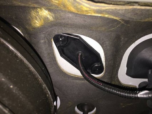

Hey all, going to order a couple of these Auxbeam cubes to install stealth mode into my grill. I have never installed aux lighting before but I imagine if desired to have these both on one independent switch that I can use a single universal Auxbeam wiring harness and split near the lights to connect to both considering each light is not much power themselves. So just wire up, connect to batt, where do you go through into cab for switch?

I might be lazy, but I just took a really long screwdriver and pushed it through the large grommet under the steering wheel and ran wires through there.

I mounted two cubes behind my grill. I ran my wires through the clutch plate into the dash below the steering wheel and installed some permanent switches. Not hard at all just make sure you're happy with where you mount everything
