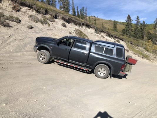

i run 35s so i’m not sure if it’s going to fit i hear that they do but im not gonna chance being stuck in a mud hole with a flat. i built my tire carrier so that wouldn’t be a problem. my tire carrier is removable and it carries my little diesel heater and the fuel for it on one side and the tire on the other

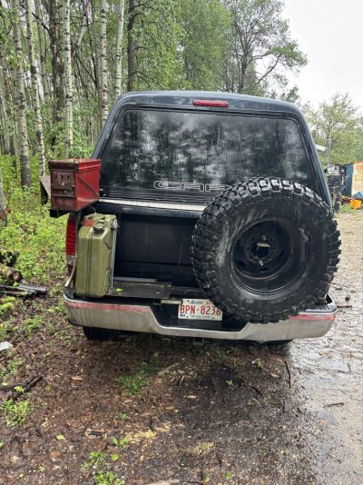

the two gates are in a piece of pipe that is mounted on spacers and a piece that goes across the truck and is attached by longer bolts it’s homemade and it works
