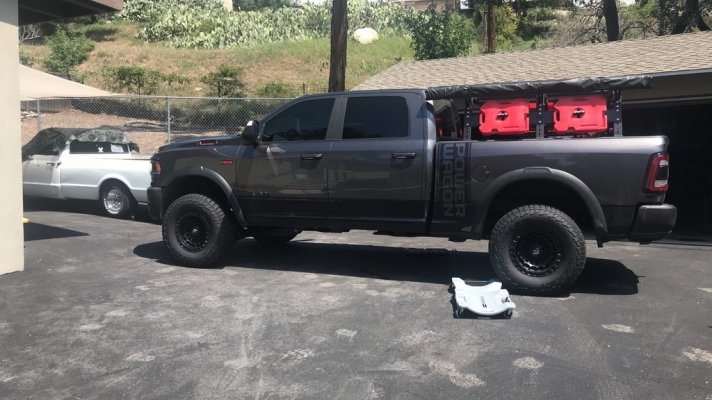

Hi guys/gals,
I've had my WKO sliders for a couple of months and hadn't really driven the PW much cus of the whole lockdown. I noticed a little after installing them that there was quite a bit of creaking when I first drove it leaving my house; the creaking would go away for the most part after the first couple of miles but is still there. I'm assuming that this is because the chassis is twisting a bit when leaving my driveway (I live on a hill and I back out of my driveway which causes the chassis to flex a bit upon leaving; and then settles as I drive it).
Last week I crawled under the truck and retightened all the bolts but the creaking is still present.
I have them set at the lowest position they would sit in on the frame rails as I read that this would minimize any of the creaking problems.
Have any of ya'll experienced this and if you were able to alleviate the creaking what you did.
Any help would be great.
Thanks in advance!
