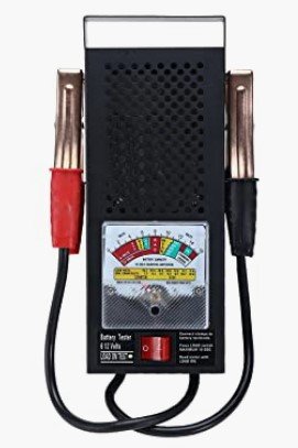

I would still load-test the battery before replacement and you may as well have the alternator tested at the same time.
Most auto parts stores will test an alternator and load-test the battery at no cost.
Or, you could buy a toaster-style battery load tester for $22 and test it yourself. This tester is a useful tool to keep at home.
The digital-style testers that most stores will use are prone to false positives. The toaster-style load tester results are much more reliable and always accurate.

My ram will not let my wife eject any cd’s. But if I hit the button it does. And she can be in the passenger side. And the truck will do this. I told her it’s the trucks way of telling her she’s the side chick. Lmao. Now recently my 81yr old mothers Mustang. (Not joking). Had some battery (I thought) issues. Kept acting dead , sometimes would jump it and it would start . Sometimes not. It’s a 00 has like 80-83000 miles. Original battery cables. So last yr I was working she calls , won’t start. Se Tx. So HOT. 81. So I go get her , throw the load tester. Pictured above. Battery bad ,grab a new one put in starts right up. Had also had a couple charging issues before that. Anyway I get a call in feb 24. Go over ,getting lights on dash. And security light. Ford thing. Now bat is good so I’m diagnosing in a parking lot. Hoping it’s not the security ring on ignition switch. (Ford). Then I notice when I turn key all lights dim like a bad battery. Which I know is good. Now I’m going at all the battery connections . Low & behold the factory negative clamp , where it’s crimped. Is not fully crimped from 00. So I spray it with electromotive cleaner & crimp the end. You know with the proper crimping Vise Grip. Not one issue since. The clamp is the 5/16-8mm bolt style steel. Not lead. So this makes my wonder if some of the battery & charging issues I’ve seen on here may have a similar problem. At least with some of em. I’m mean my mom’s mustang went 22-23 yrs with the cable that way. And there was little to no corrosion on the terminals. And I’d imagine anytime the cables were messed with or battery removed . Then it would start back up. A place to look if you’re having battery issues. Sorry for the novel.
