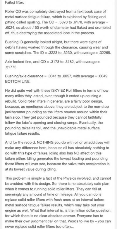

So I’m 1.5 hours in (3/4 finished) with the 540Rat blog. Amazing how smart this guy is. But stumbled upon this.
Those of you persistent about using 5W30 to try and prevent lifter failure are wasting your time.
Assuming based off his analysis all we can do is just GUESS when a lifter is about to fail and get it replaced before it causes serious engine damage?
He does mention that 5W30 could potentially assist in engine noise due to being a bit thicker, but apparently we can’t do anything to prevent lifter failure and it’s good to know idling isn’t a bad thing for them! I thought idling was bad for Hemi lifters.
In the end, if under warranty, we’ll still be questioned and potentially blamed for this due to oil or change interval etc etc, but the truth of the matter is, OIL/Filter play NO ROLE IN LIFTER FAILURE!

Right after bottom line. It says solid lifters. We do not have solid roller lifters we have hydraulic roller lifters. So i would not read to much in to that. But thats me.
EXACTLY apples and oranges. He even states about the valve lash causing the hammering - hydraulic lifters have no lash.

All I can say is what gave you the right to post that on here, is this the opinion of some Rummie lab rat that actually knows anything outside the lab, what's with all of those specs is that suppose to impress us, do you yourself have any working knowledge of the internal combustion engine, and what different oil viscosities do along with additives like Lube Gard bio tech can do, have you read in detail in this forum of what we do to combat this issue, and these are Hydraulic Roller Lifters, and what's with what we're doing is no good, But I have to close with this, Opinions are like Sphincters everybody has one, keep it closed on here.
I think these lifters were on some very high performance or race motor and the specs are to show what he measured during teardown and inspection of the failed part.
Really has no bearing on our lifters or such.
