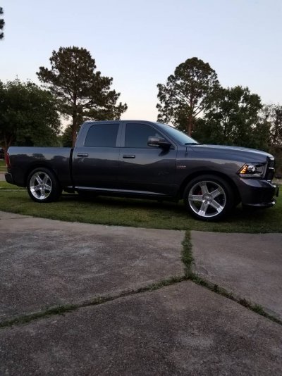

Decided to wrap the plastic trim around the 5th window on the back glass. It's not recommended because it is plastic, as well as orange peel texture. I live in Houston where plastic fades fast and the back window bugged me with it fading, so gave It a try since I had some. It actually stuck good (cleaned surface, and used heat gun) when the glare hits it you can see the texture but I'm happy with it. Blends in with the glass much better!

What did you wrap it with?

Wrapped with 3m, and yeah I knew that would be only option to get rid of the orange peel.

Could this also be done to the pillars between the front and rear windows?

It will deff work on that, it's a smooth painted surface. That's pretty much what it's for

On my '16 1500 Lone star they are the same plastic as the two bars on the back middle window.

Yeah mine's 16 too..there is paint underneath, removed that the second day I got it lol03cc22a4ed2f0885e3a578c66d36558c.jpg

I hate the tape on the B column, is the paint underneath clear coated like the rest of the truck? Any tricks or just carefully use a razor, is there adhesive?
I want to do this!!!

Just wait till a warm day - Its just vynal wrap- U need to remove two screws on the inside of the door jam- Takes about 5 mins per sideto peel- Then some goof off and u are set- did mine 3 years ago when I got the truck home- Looks so much better IMO
Just google " Remove pillar vynal on Ram" there are tons of videos on line
