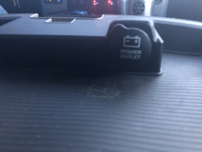

Just picked up a new (to me) 2017 Ram 1500 Big horn with the Uconnect 8.4. I've got the USB option on the screen, but in the center console, I only have a 12v socket. I'm thinking I should be able to pick up the USB hub and harness and connect it to the Uconnect system. Wondering if anyone has this or more info for me. TIA

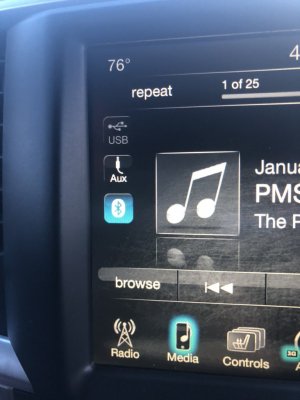

USB option is grayed out like there is nothing plugged in. Obviously no hub where there should be one. The truck has 9k on it so I can’t imagine the previous owner added the console?
I think that even if you have a working USB input it will be grayed out until a device is plugged into it.

I would follow rbats advice on the vin.if the icon is on the radio if you had a USB it should work.the icon will be grey until you press it.what happens when you press it?the radio should display connect device .what happens when you use the steering wheel voice commands and say change source to usb?do you have a auxiliary jack somewhere?

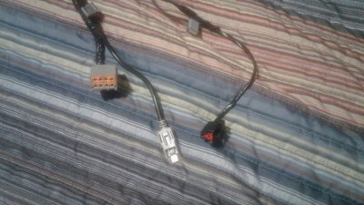

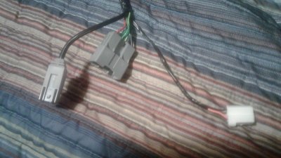

I’ve got a console lid with the media hub if you are interested I could sell you the whole thing or just the parts you need.
Can you PM me what you want for it please?

The radio has a USB port on the back and the usb cable may be in the harness you will have to remove the radio to see if not you can purchase the jumper harness usb from the dealer. Do you want just the media hub and wiring or do you want the whole console lid ?

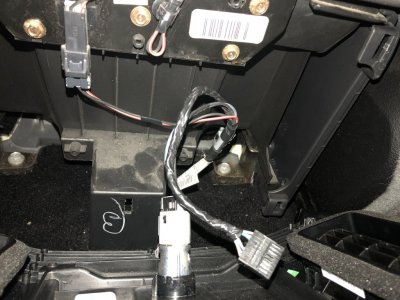

These are the connections that should be there for a media hub15157269794461737383242.jpg
et todd
Dec 9, 2015
223
60
And the male end of these coming from under the center dash going into the front of the console
et todd
Dec 9, 2015
223
60
The only way to confirm is to check the harness coming from under the dash.this console to me shows some age.the dust on the inside seems to be a lot for a 2017.what does the top console bin look like it should be the new type with the phone holder.if the connectors are under the dash you will need a different console harness and a media hub lid.if they are not for whatever reason the truck didn't come with a media hub.I have never seen this before on a 2013 up ram.
