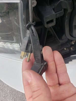

Wth is this? Block heater on gas motor?
Japslapr
Mar 4, 2020
12
Kentucky
Just found this... never seen anything like it.. block heater? Thought that was a diesel thing.
I did find maintainence records for this thing in French.... so I think it came from Canada... which might explain the need?
Buddy
Apr 13, 2014
2,149
930
Ottawa, Ontario - cool town
Yep, block heater. I use mine anytime it's cold out parked at work. I love it. Helps truck start like a dream on even the coldest nights and I start getting heat out of the vents down the road way sooner than if it hadn't been plugged in. Block heaters on even gas engine vehicles have been a staple up here my whole life.
Pretty well standard equipment on any gas motor/vehicle sold in Canada or the Northern States,lol
