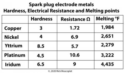

The platinum electrode is the problem as it has over 6 times the resistance of equivalent copper electrode spark plugs. The end result is the coils aren’t putting out enough power to overcome the added resistance. Keeping the platinum plugs will ultimately cause more issues than they are worth.
Return the platinum plugs and pick up copper ones.
