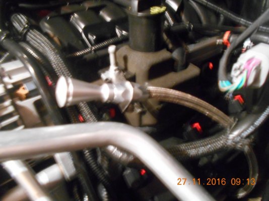

A diagonal hole in the fill plug isn't going to do much,as far as letting you check the fluid level.A 45 degree hole might work.Lokar dipsticks have a straight end on them,that doesn't bend,so diagonal isn't going to work.I run a custom 31" long Lokar engine dipstick,and it would need an angled hole in the fill plug to actually work as a transmission dipstick on the 8 speed

Yep, angled is what I mean. I've been looking at the case for possible options. I'll have to pull the pan and see if there is any space where a straight dip stick could go in from the top or if there is any way to add a small kick out to a PPE pan. I'm committed to finding a way to simplify the fluid checks.

Once you have the level set ,you shouldn't need to check it again till your next fluid swap.The transmissions don't have a rep of leaking fluid,and if they do,you're still going to have to pull the level check plug to add fluid to it,after you fix the leak.Your not going to pour much fluid down a Lokar dipstick,at least not easily,lol.The fluid level is above the pan rail,so adding a kick-out to the PPE pan isn't going to do much for checking the fluid level.You'd need to weld an angled extension onto the fill plug,that'd accept the flexible dipsticks bottem end,and have some way of attaching it,so it wouldn't work it's way out,then you'd have to make the dipstick removable to be able to take the fill plug out to add fluid.That would give you one more leak point.This is another idea where i think you might be over thinking it,lol
