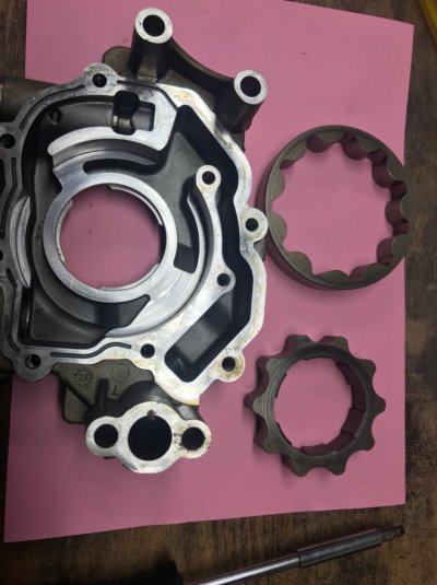

I just opened up the oil pump from the motor with the lifter failure. The cam was pretty eaten up, I posted the cam image further up the thread. Overall it doesn’t look too bad, I was told this was a high mileage motor also. There are some scratches but nothing enough to catch a fingernail. In my un professional opinion it looks like it should still work fine if you didn’t want to replace the pump. Just posting pics so you guys can see...

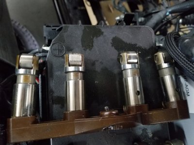

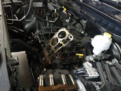

Local performance shop tore into the engineer today and found two bad lifters with minor wear on the cam. Both failed lifters still spun though. The picture of the lifter I posted earlier was completely ceased.
Ordered Jay Greene's Stage .5 cam kit, gaskets, timing chain, plugs, etc. Also switching to Amsoil

Sorry this happened to you, do you have any pictures of the tear down or the parts left over? Also, if you don’t mind could you post up the total cost to you after it’s all said and done.
