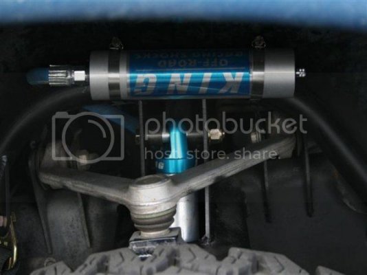

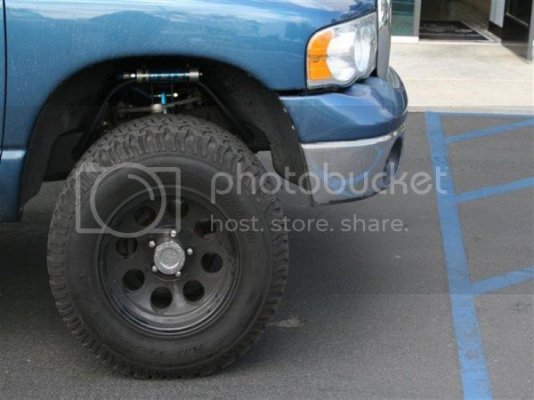

We need more info on this truck. Pictures, story, build thread, something!
I hear you man. Based off the thing they told Sandiego, I'm not sure if I can trust them either. I don't know how they claim no coil bucket contact. I won't be spending $400 to find out either.
It was done in 2008 and it was a 2006 Ram 1500 2wd. We did a 4" CST spindle, the custom king/shock hoop set up, 17" wheels and 33" tires. That was it very simple the customer just wanted to be able to run a king resi

Sick setup! It really doesn't look that difficult. Of course it requires balls to cut into your frame like that haha.
