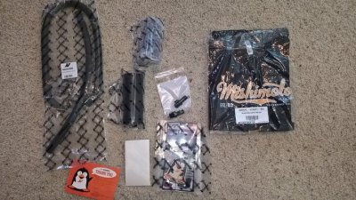

Ya I was hoping to install this weekend, hose doesn’t have any size text on it
Mishimoto
Mishimoto
May 9, 2013
48
31
5.9L Cummins
Well Steve you have more problems, your hose barb fittings are to small for the hoses. The hose I.D. is approx 1/2” and according to your “online instructions” the fitting is 3/8”npt x 3/8” hose barb. So even though I appeared to get the correct kit and parts I obviously didn’t because I cannot install it as delivered.
Question is what’s incorrect the fittings or the hose size?
Anyone know what size hose connects fits the engine connections?
:throw: Well, you are correct, the fittings are not the correct ones. We looked at our kitting instructions for the warehouse after seeing your post and the description of the part was correct, but the part number was a digit off. So, instead of 3x8" NPT x 1/2" fittings, 3x8 NPT x 3/8" fittings were supplied. I have a pile of the correct fittings that will be over-night shipped out to everybody today.
I truly do apologize for these issues everybody. I can assure you, this is not how we normally operate and we're working day and night to correct the problems.
-Steve

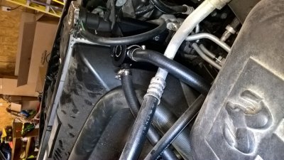

package arrived
Everything looks to all be there. I appreciate Steve and his sincerity and response to make things right. I hope to get it installed this weekend after deer hunting. Oh, and the fittings are correct.

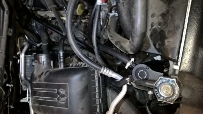

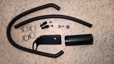

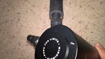

imstalled
Pretty easy install. I thought of detailing an install, but their video is as good as any.
https://m.youtube.com/watch?feature=youtu.be&v=RQxtKUxeKrA
One tip I have, is to take the can apart first before installation and put a dab of oil on the O ring. Because, I found once installed, was near impossible to take the can off. It was a tight fit.

Finally installed mine today, I used a 90deg fitting for one of the hoses to kinda tuck it away. I also had to wrap the can in a towel and place in vise to remove it. I then oiled the o-ring seal and tightened the can back by hand with normal force.

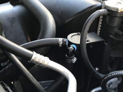

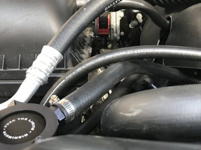

Here's a pic of mine on 2019 b35631a6d9fa34e792b4b6996b8f6072.jpg36bc9bc69d67a8a30e36b0c1c5788252.jpg
