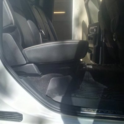

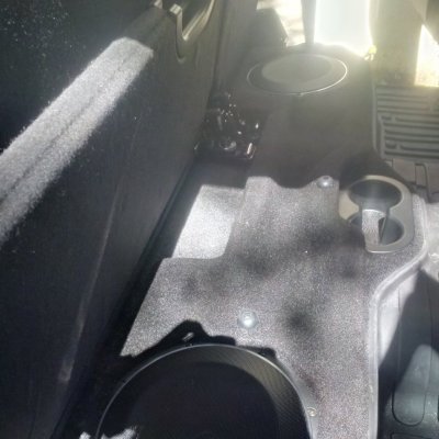

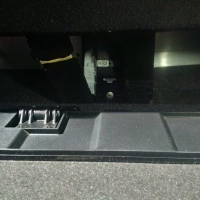

Final product. JL audio stealthbox with 2 10TW1. 3/4" seat lift, 1/4" load floor lift. Bolted down with grade 12.9 M12 1.75-75mm Allen bolts. Amps on back wall and got some automotive carpet underlay to underlap the back wall cover and under seat felt so no wires visible. All you see under there is the amp faces.
