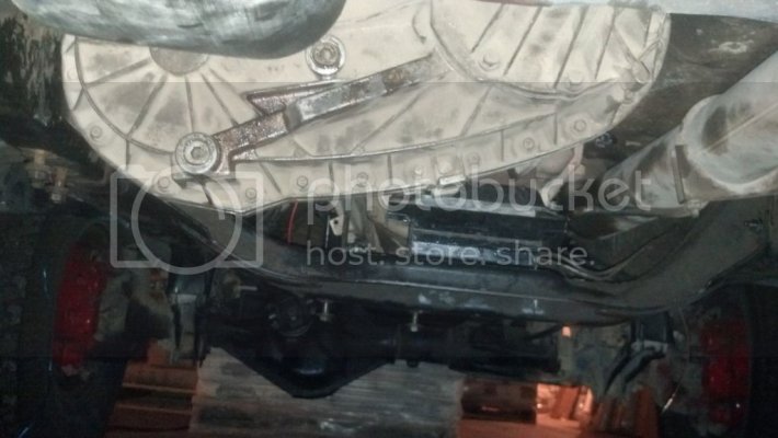

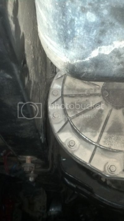

so, couple things, 3rd gen pedals can be made to look like they will work, but won't. in case anyone is wondering. lol. through redneck engineering and a piece of a flashlight we got 'em to work, but the pedal didn't line up with brake light switch. but conveniently someone started parting out a 2nd gen manual just over an hour drive away today. so i ran out and got his pedals. almost have them completely in, but need some smaller hands to get 'em the rest of the way. should have that taken care of tomorrow. another $70 worth of oil for my tranny and tcase. they are now running fresh oil. 99% of the wiring is done. and i need to figure something out for my tcase linkage, needs to get extended a bit...but enough talk. here is a couple teasers....
