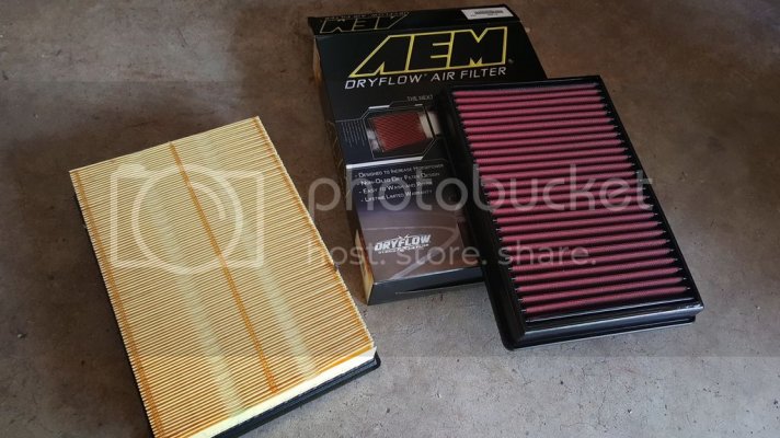

First day after I got back home to Alaska all those packages in my garage where just screaming my name, so like any sane man with some free time on his hands I pulled my new truck into the garage and started taring it apart. Knowing I only truly had a few hours of time I decided to go ahead and install two of my easier mods. A 'performance' engine air filter, and a Cabin Filter.
'AEM 28-20247 DryFlow Air Filter'
I was goofing off one day waiting for my new truck and though, hey why not get some 'performance' parts? Wanting to be cheap I thought about getting a Cold Air Intake but couldn't settle on anything I liked. I stumbled across this Airfilter and liked the reviews so I thought why not? Best part is its an oil-less filter, no more worrying about gumming up O2 Sensors!
Stock VS AEM
Extremely easy install/replacement. Open the lid, pull out old, insert new, close lid. But I'm sure y'all knew that and if you didn't... You should probably go check your air filter as they are supposed to be replaced / cleaned regularly...
It even came with a sticker to remind you that it is an oil-less filter.

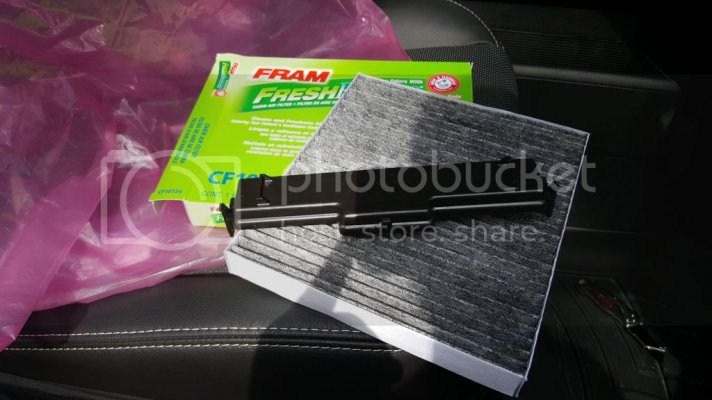

Next came my Cabin Air Filter

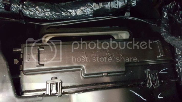

'Evaporator Heater-Door' (Filter Cover)
Cabin Air Filter
Original instructions are from the 'Cabin Air Filter Mod' Thread
Last year on my 2014 Ram Ecodiesel I performed this modification and concidered it a must have. Having already installed it once I figured the second time around would be easier. I was right and yet... wrong...

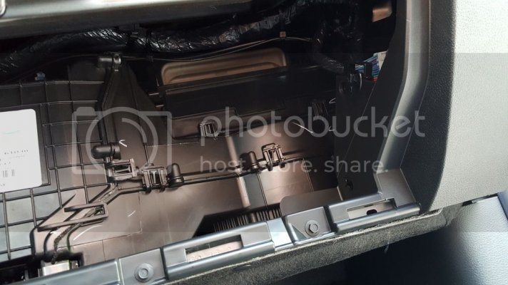

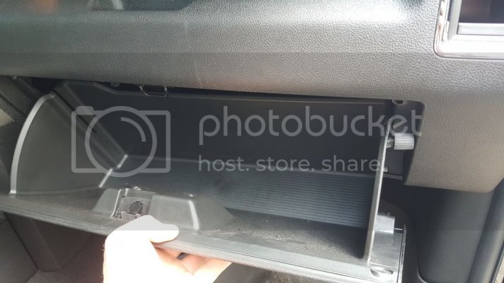

First I Removed the Glove Box

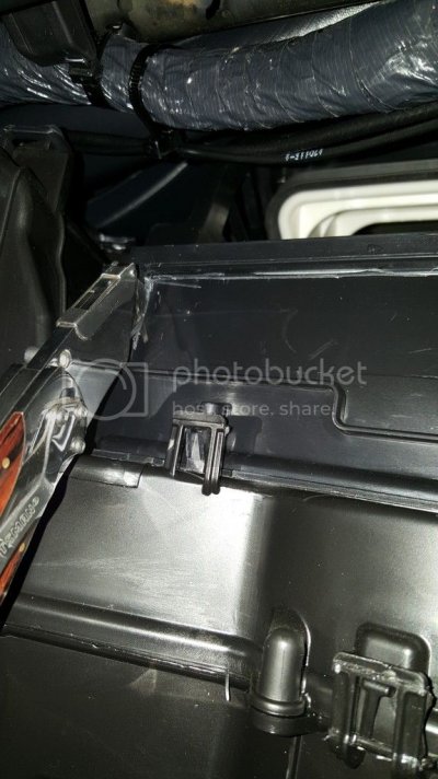

Then I located the the area where the air filter would go if it came equipped from the factory

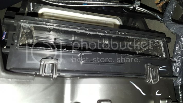

Carefully I used a razor blade utility knife to cut out the port. If you are doing this make sure to cut on the inside of the lines

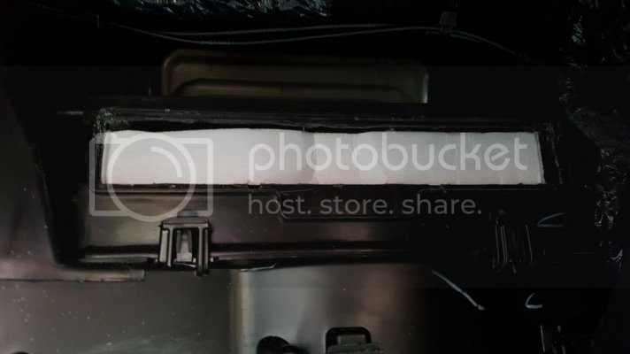

At this point you just have to insert the air filter, however or my vehicle this year there where sharp plastic protrusion on the inside that the filter kept getting stuck on. I didn't figure this out for several frustrating minuets until i reached in there a sliced my finger after about damn near destroying the filter trying to shove it in/rip it out. Once I had isolated the problem I used my knife to cut out a template the size of the filter + about 1" in length. I incerted this and held it up against the sharp plastic pieces and slide the filter in underneath the cardboard. This worked like a charm, then you just have to pull out the cardboard. (I was frustrated and didn't take pictures of this whole process)

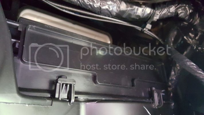

Finally all you have to do is pop the cover onto and reinstall your glove box and your done!
NOTE: the covers don't always 'snap' in place, sometimes you have to hold it in up while you push the tabs until they click.
