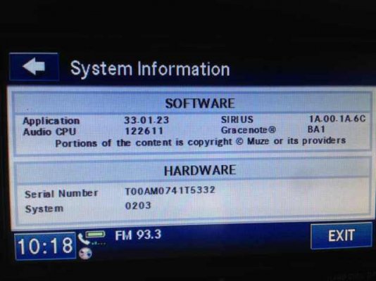

Does anyone know how to read the software version on my radio?
I would like to load the latest software version on it as discussed in this thread.
Even though I don't have NAV I thought I would try the update anyhow, but I can't figure out how to read the version number or date.

You got a good deal on the radio that's for sure. But it looks like your out of date :) give me a few and ill post up what it should look like since I recently updated my software.

I think your really out of date. They have updated a lot. You should do it :)
