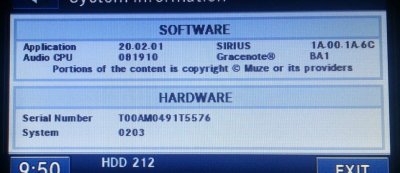

I still have the factory radio that was in my truck. I just tried to update the truck and it did not recognize it from the CDR. Any advice? Should I have burned it to a CDRW?
Edit below
I added a pic of the system info screen in my gallery. If someone could tell me what download to use it would be much appreciated

Let's see if this works

I didn't see much about that version, but it looks like a different software series than the two mentioned in this thread - meaning the ones that are either 30.xx.xx, 08.xx.xx or 10.00.11
I think it had something to do with RHB radios and Serius travel link. It looks like the upgrade for you would be version 23.04.41. I have to look into this also since some searching says it works with the 430 RBZ that I have.
Which model radio is that? 430 RBZ or one RHB?
Look at this link and especially post #5 I might have to see if I can find that version to download myself.

Well I upgraded to the 23.04.41 software. It did take away saving the memory of my category scan. In other words before if I would select 5options for serious no matter what I did those 5options were always there. Now once I exit the menu or turn the truck off the categories or all deselected.
